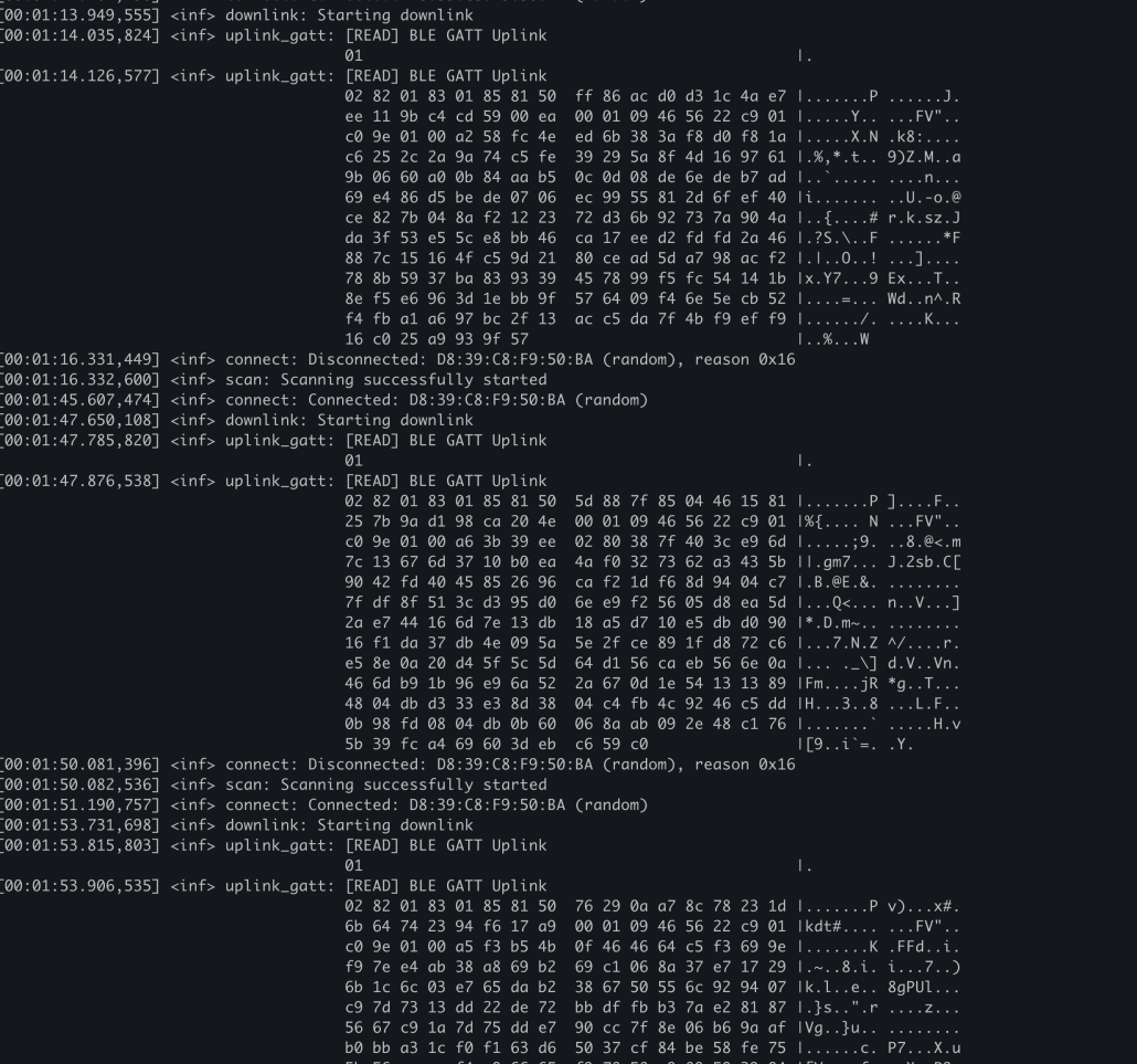

In my setup, I am using the pre-compiled binary that is built for the NXP FRDM-RW612. Once I program that in and add Golioth credentials to the Gateway, I basically don’t need to think about it again. The Gateway logs the connections that are happening, but cannot see any of the traffic transiting through, since only the Cloud has keys paired with the Bluetooth device.
Example log output from the FRDM-RW612 acting as a gateway

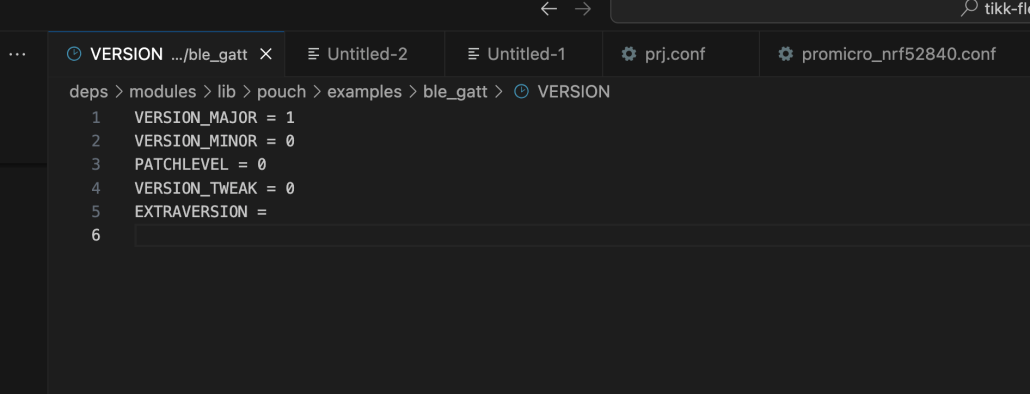

Looking at the BLE GATT sample on the Pouch repository, we can see that OTA updates are already implemented using MCUboot. The device reports its firmware version using the VERSION file in the repository:
This is used to report MCUboot firmware version at startup and to check for new available versions on the cloud. When a new version of firmware is deployed to a Cohort and the Bluetooth device checks in with the Cloud, that device will see the updated version of firmware is available as part of the downlink data. It sounds complex, but works really smoothly…let’s look at how.
