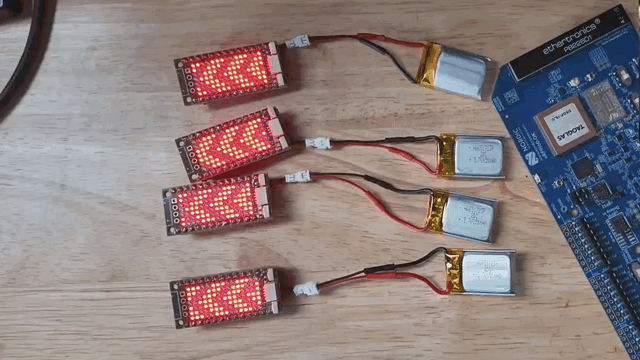

Sure, blinking an LED from the cloud is cool and impressive when transiting the various systems we transit. But what if we blinked a lot of LEDs? And put them all in order. Perusing the available chips from LCSC (more on that later), I found a familiar chipset: the IS31FL3731. It’s a 9×16 LED matrix display with an optional audio input that can match the pulse of input audio. It’s targeted at EQ displays for stereos, but also makes a fun way to display text, graphics, and whatever else you can dream up…but maintaining that “Times Square in the 80s” kind of look.
This board has 105 LEDs in a 7×15 matrix, basically the most I could fit onboard with 0402 LEDs in the available space. The 7 pixels high is a crucial number to fit a minimalist 7×5 pixel font size. The I2C driver allows control of individual LEDs and has framebuffers to allow animations without regular interaction with the driver chip; you set up the frames and away you go. Easier said than done, but Mike Szczys made short work of the driver in Zephyr and plans to upstream it at some point as well.

In the face of US tariffs, getting any custom electronics made right now can be tricky. The supply chain is inexorably tied to other countries, especially China, even if we decided to do domestic production. I couldn’t find what I needed on US marketplaces at the price point I wanted, so instead I decided to lean into lower cost parts (LCSC) and assembly (JLC) and then pay the tariffs. As such, the parts on this board were largely informed by what I could get on that marketplace and what fit onto the somewhat limited size of the board. Here are the features/part names:
  • 105 LEDs in 0402 format, individually addressable in a 7×15 matrix with the IS31FL3731
  • Two H-Bridge chips (L9110S) for driving a single stepper or two dc motors
  • 3 axis accelerometer (LIS2DH12)
  • Temperature sensor (TMP102)
  • QWIIC / Stemma header to expand breakout boards*
  • User button
  • Reset button
  • A voltage divider that monitors battery voltage
Additional capabilities added by the Tenstar ProMicro and nRF52840
  • Additional GPIOs I can solder to (5 digital, one analog)
  • LiPo battery charger on board
  • Load switch for all peripherals except motor driver
  • USB Input to the nRF52840 (get serial terminal using USB-CDC)
  • NFC tag emulation (via the nRF52840 and onboard flex connector)
