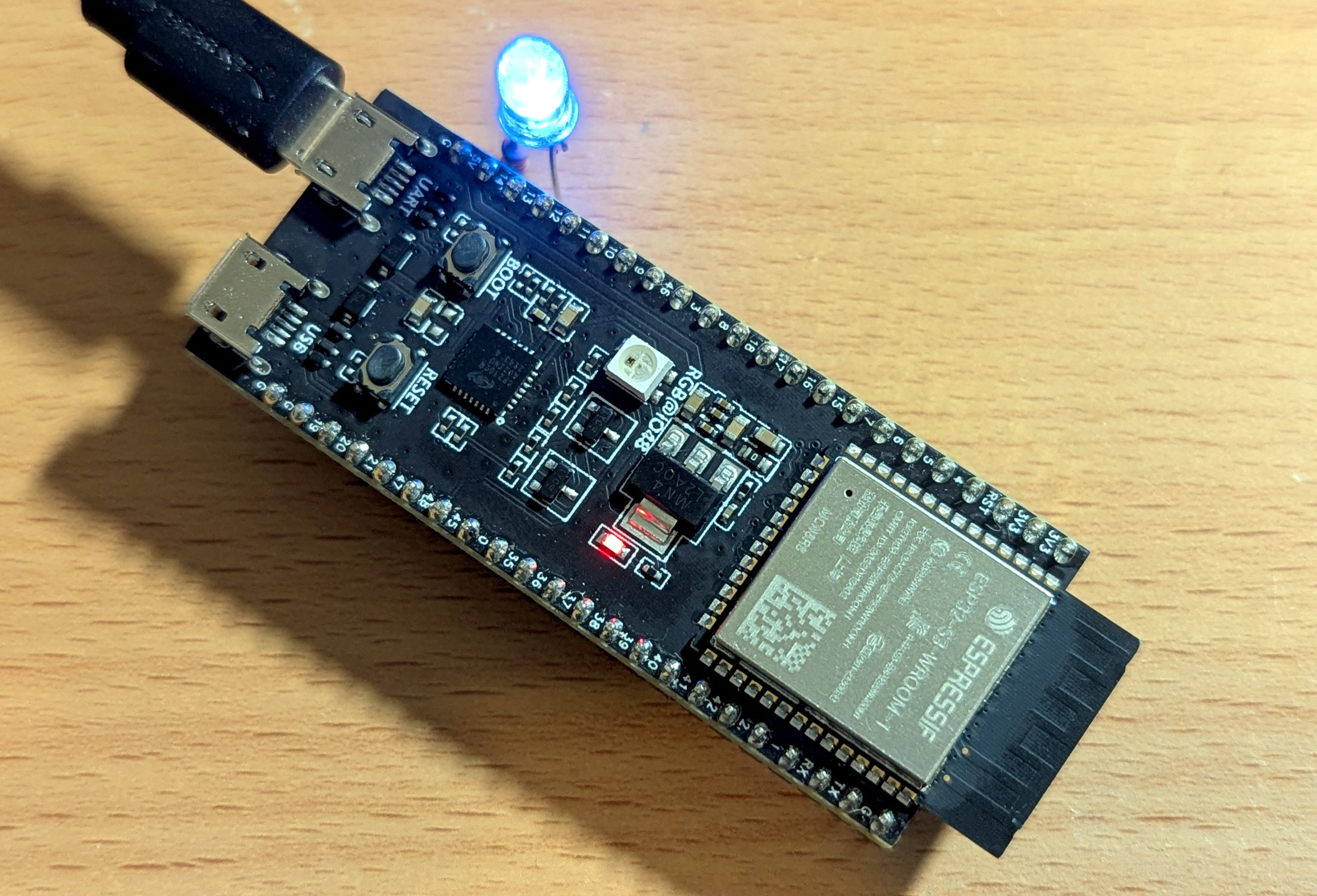

Black development board on a wooden desktop with a blue LED illuminated.Espressif maintains support for the ESP32 family in Zephyr, so building for this ESP32-S3 is trivial when you already have Zephyr installed on your development computer. I found that all I needed to do was add hal_espressif to my allow-list and run a west command to fetch the binary blobs.

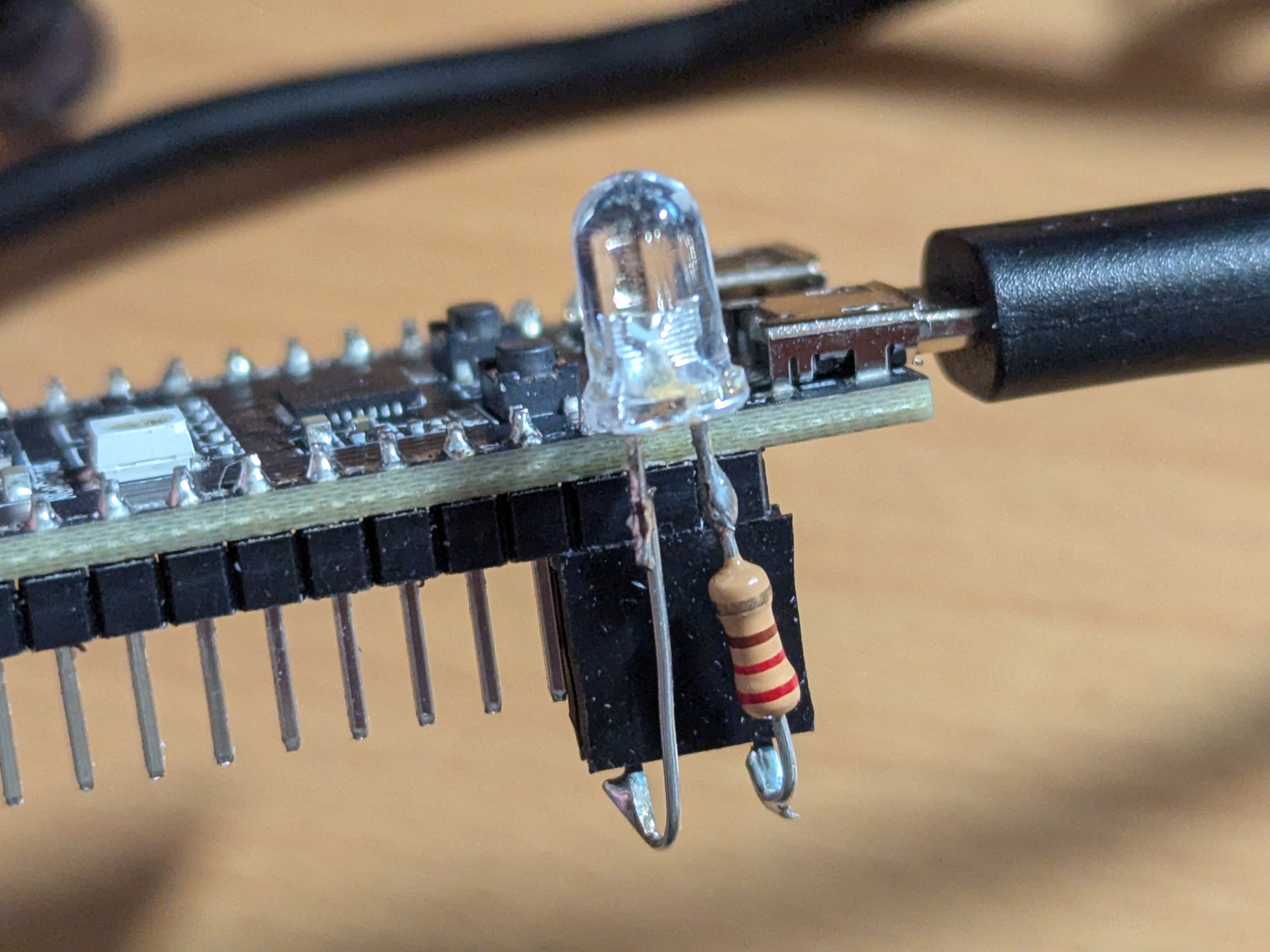

By default, the sample application allows you to change the state of an LED attached to the board by issuing settings commands from the cloud. However, the ESP32-S3 doesn’t have an on-board LED. Without one, the sample code will fail to build. So I connected an LED (and current limiting resistor) between GPIO14 and Ground. Add an overlay file to map this additional hardware in the devicetree.

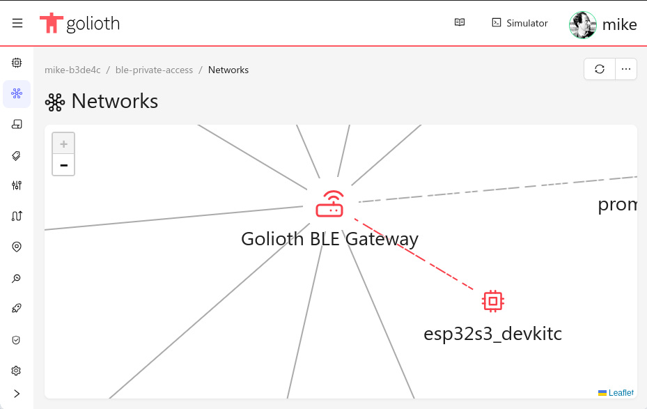

As I mentioned, I already have a gateway device running. If you have not yet done so, follow steps 1 and 2 from the getting started guide. After a few seconds, the device will start advertising and sending data up to the cloud!
Topology map showing an esp32s3_devkitc connecting to a Golioth BLE gateway.Explore both Uplink and Downlink

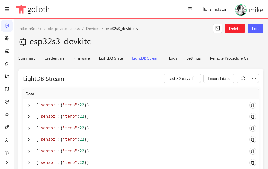

The example code sends simulated sensor data from the device to the cloud. From the Golioth web console, we can use the LightDB Stream tab to view the “sensor” readings received on the cloud.
I didn’t actually connect a hardware sensor up to the device, so we’re only going to receive 22C for every reading as long as this device is powered on. However, as covered in the previous step, I did add an LED to this board.

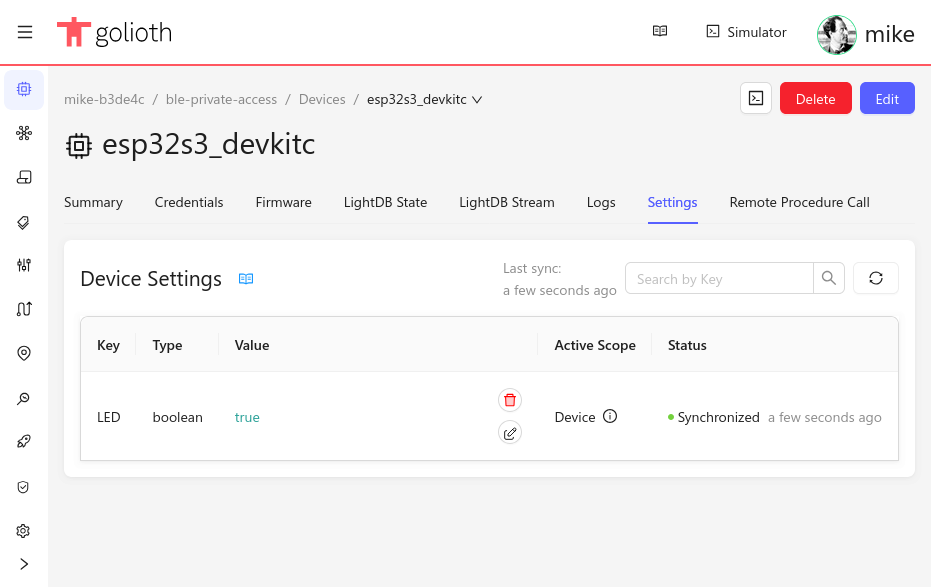

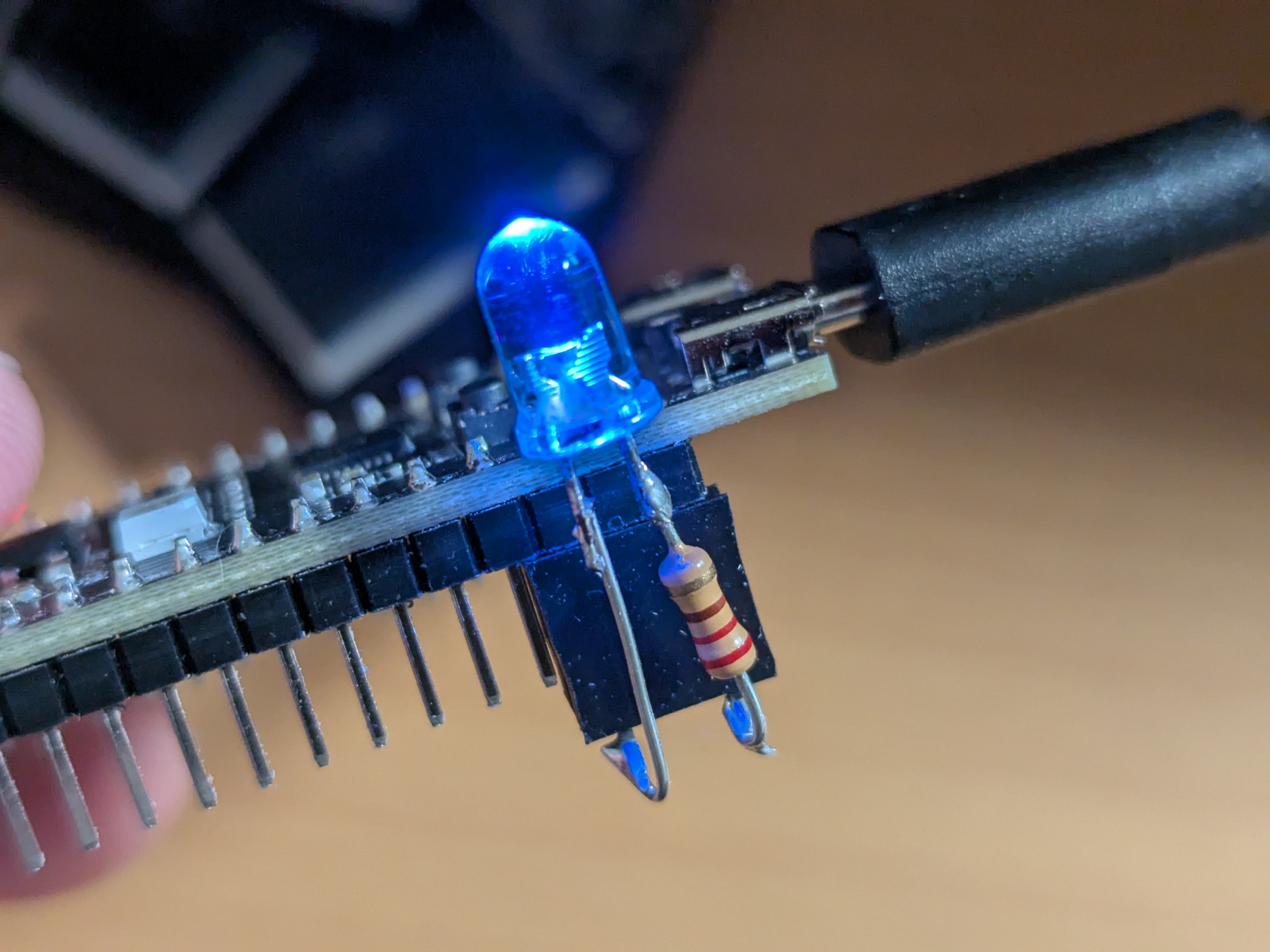

We can use the Golioth Settings service to change the state of this LED from the Cloud. Settings can changed at the Project or Device level. Here I’ve edited the device-specific setting and a few seconds later the LED lights up!
