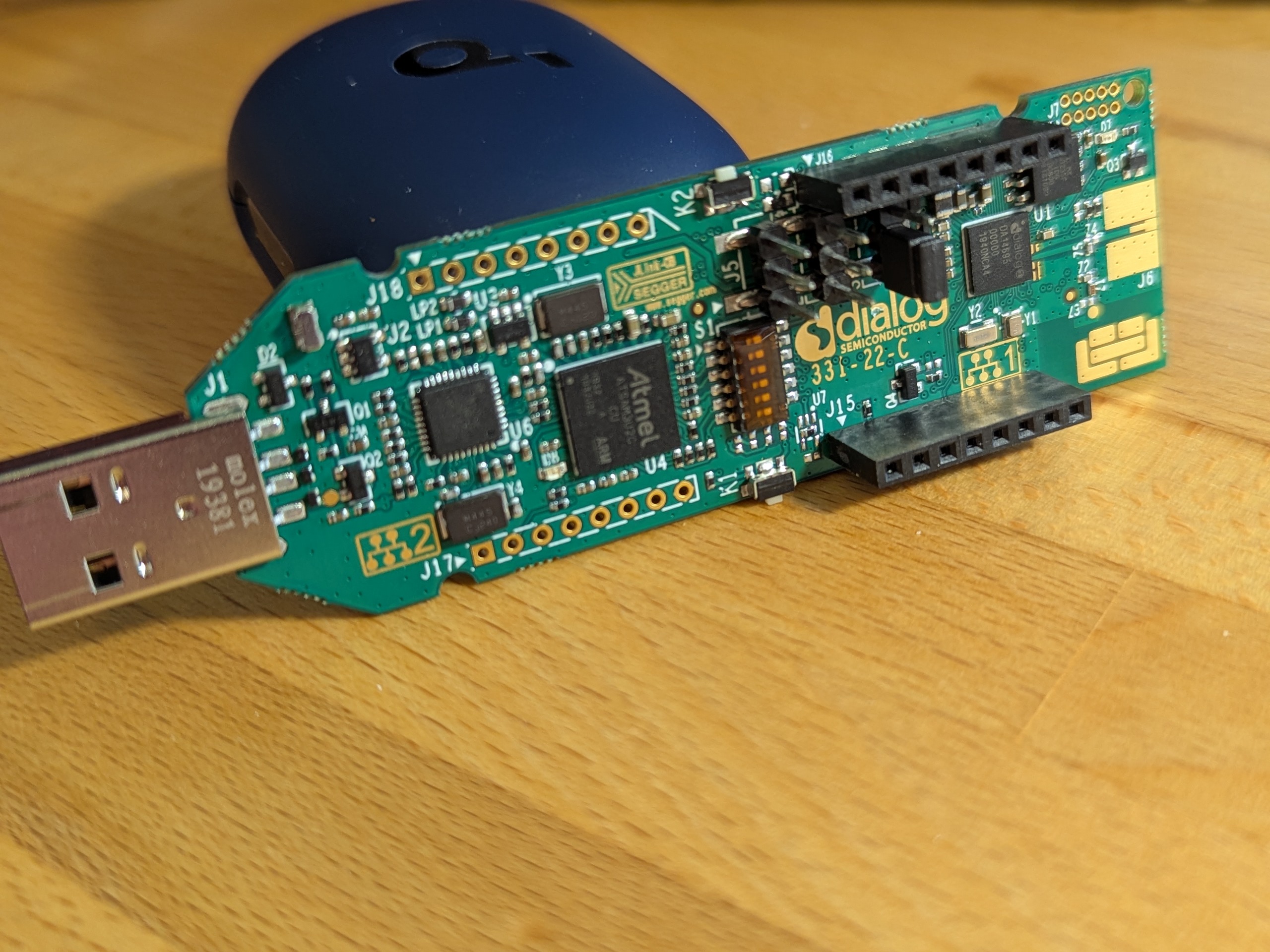

Renesas da14695 propped against a wireless earbud case.While the Bluetooth-to-Cloud service doesn’t require that leaf nodes run Zephyr, we have built the first example applications on Zephyr. The first thing we need to do is get ready to build for the Renesas DA14695.

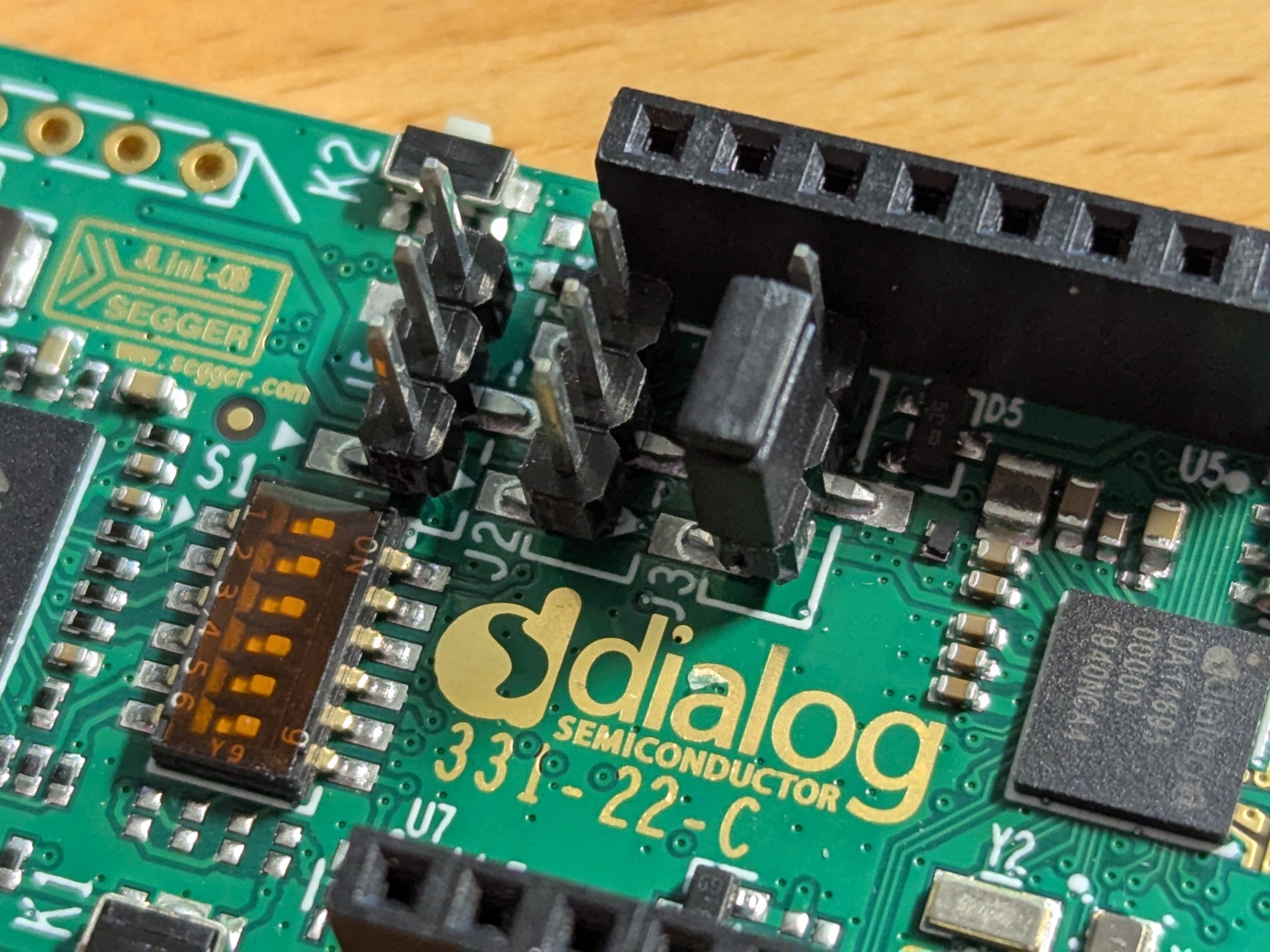

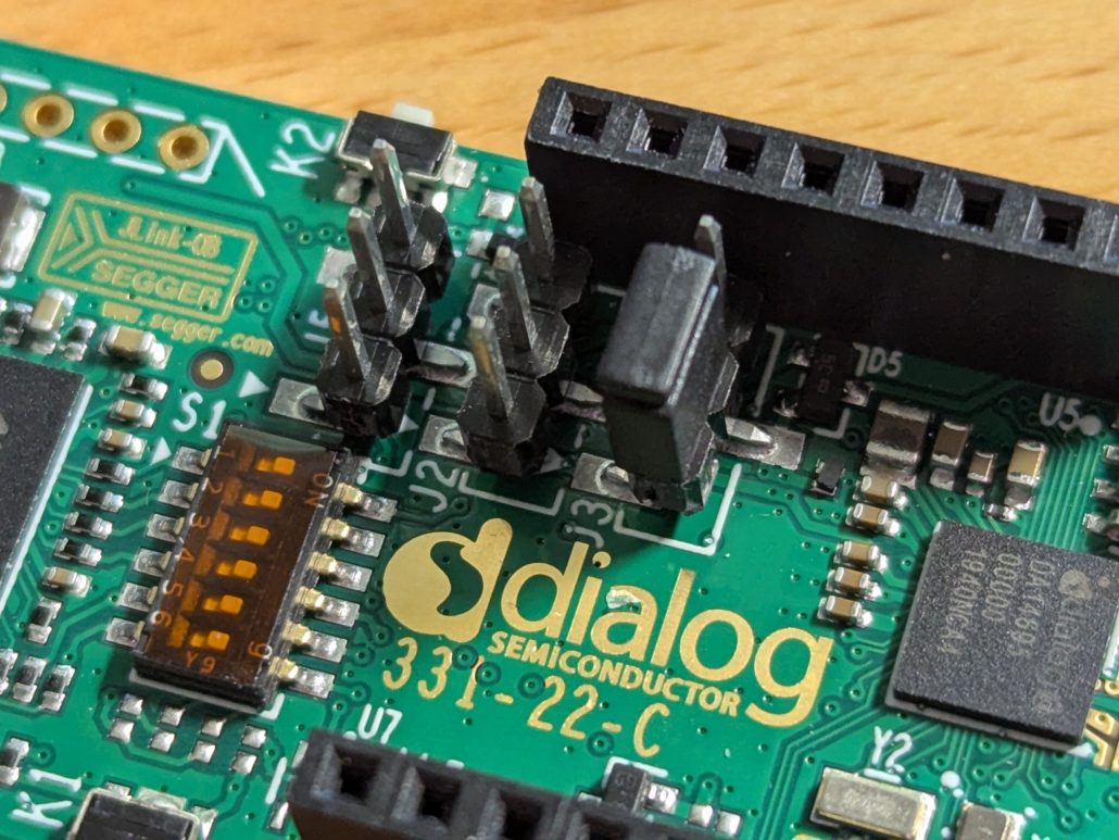

Renesas da14695 jumper settings for 3.3V operationMy device shipped with a jumper installed on J2 between pins 2-3. This runs the board in 5V mode, but I found that Zephyr applications like basic/blinky didn’t want to run (as if the clock was not running). This was resolved by moving the jumper to J3 between pins 1-2 which connects the chip to the 3.3V rail.

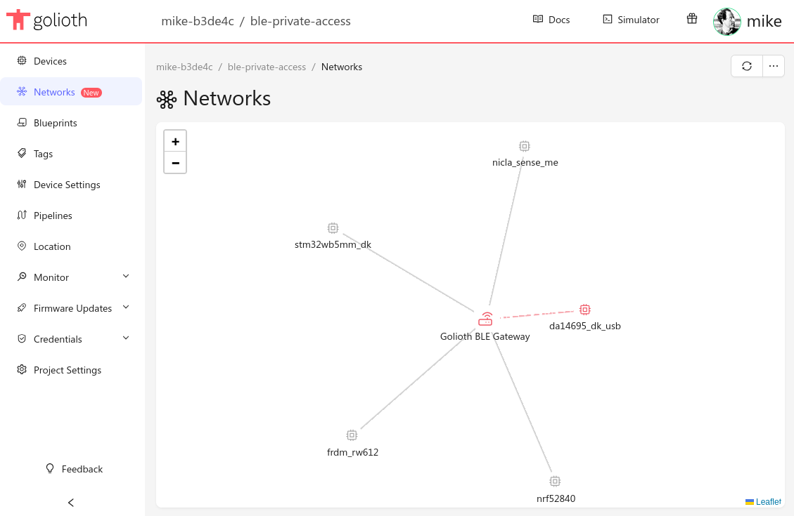

The device will reboot and begin running. It’s worth mentioning that the build command above includes a REPLACEME placeholder that needs to be replaced with the Golioth DeviceID for this hardware. Without this, the cloud will not recognize this as a valid device when receiving data via the gateway.
Golioth Network Topology Map shows da14695_dk_usb connecting to the gateway

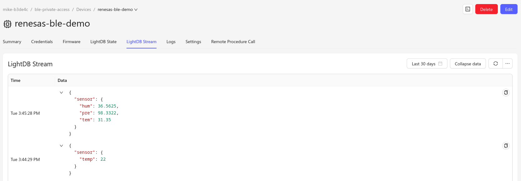

In the video we demonstrate going a step further by connecting a BME280 temperature, pressure, and humidity sensor up to the Renesas DA14695 so that we can send actual sensor data. It is actually quite simple to add data to the upload.
Let’s look at the pouch_event_handler() callback. You can see in this function we are packaging up some JSON code to send a (simulated) temperature value. This payload may be replaced with any valid JSON, just be sure to change both the JSON string and the length in the write API call.

Sensor data received from da14695 over bluetooth gateway
