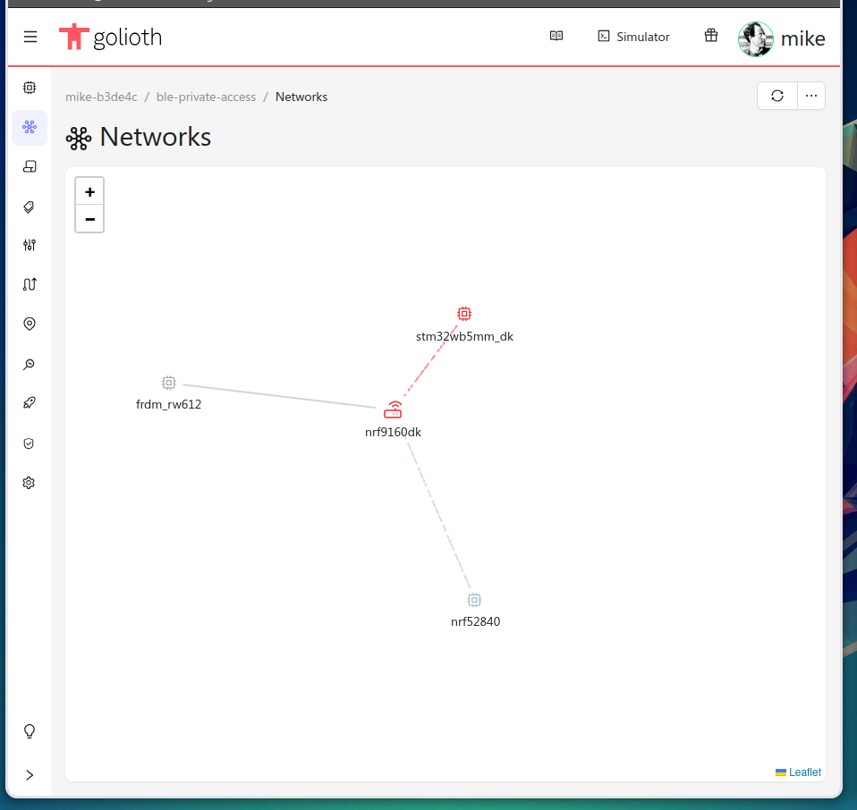

Viewing Network Topology and Data on the Cloud
Toplogy map showing connected bluetooth devicesWhen viewing the network topology you can see the gateway device at the center with Bluetooth leaf devices connecting to it. Above we see my project has three leaf devices. Two are not currently connected, but the newly added dev board is connecting and sending data!

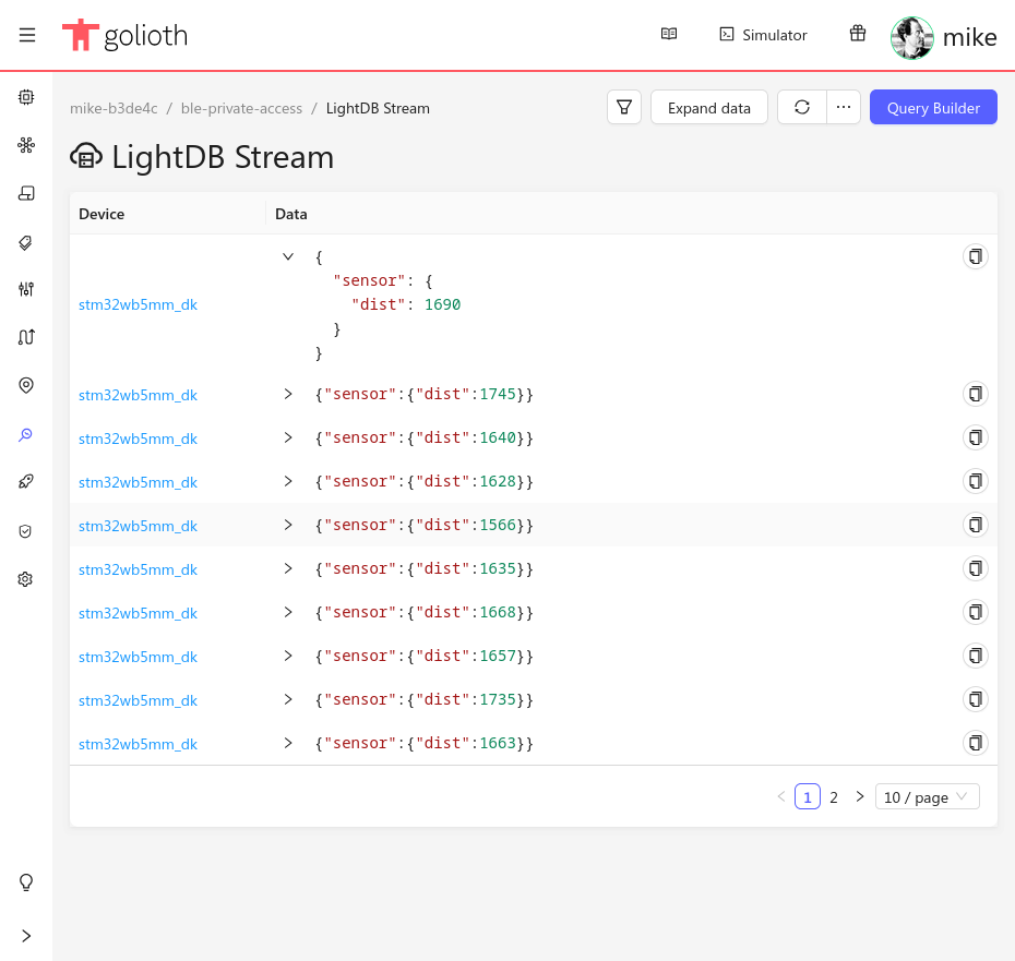

Golioth Console showing time-of-flight sensor data sent from a Bluetooth Low Energy deviceWhen viewing the Monitor→LightDB Stream tab of the Golioth web console we see the data that has been received from this device. This is different from the simulated temperature sensor data that is sent by default. If you watch the end of our video you can see the process used to enable the onboard time-of-flight sensor and how to send that data to the cloud.
