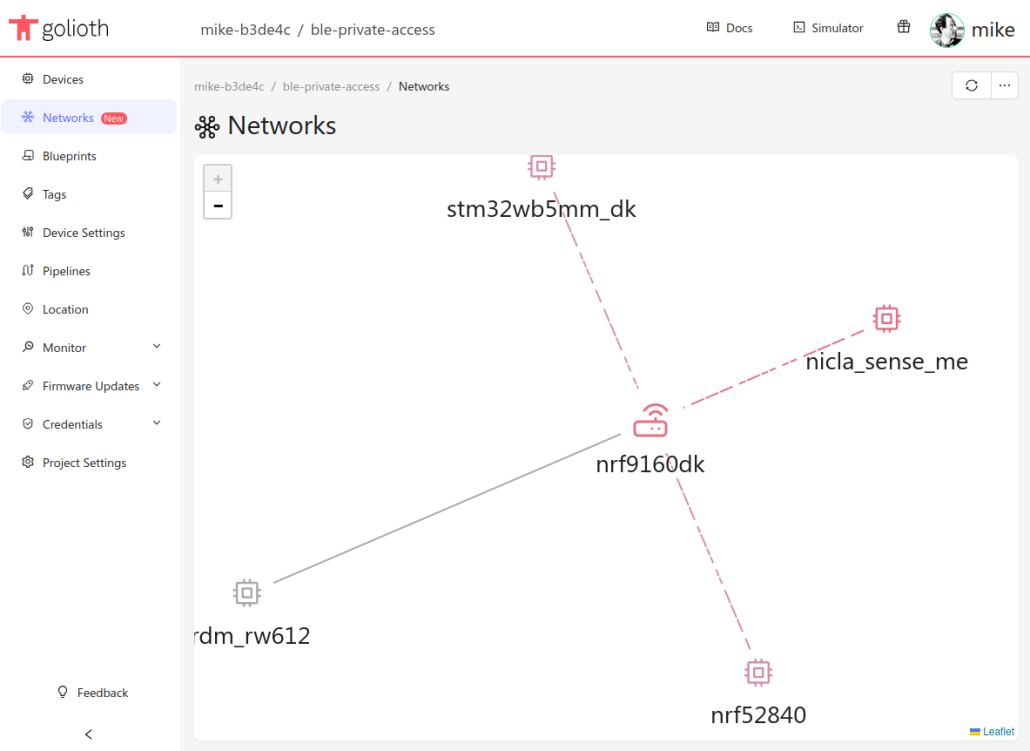

Golioth web console showing Bluetooth network topology with four nodes connecting to a gatewayTo add Bluetooth devices to an IoT fleet, Golioth built Bluetooth gateway firmware that you can use to bridge between BLE and IP. Each device uses the Pouch protocol that advertises using GATT. Since the Gateway is able to authenticate with Golioth, it can pass data from leaf nodes to the cloud.

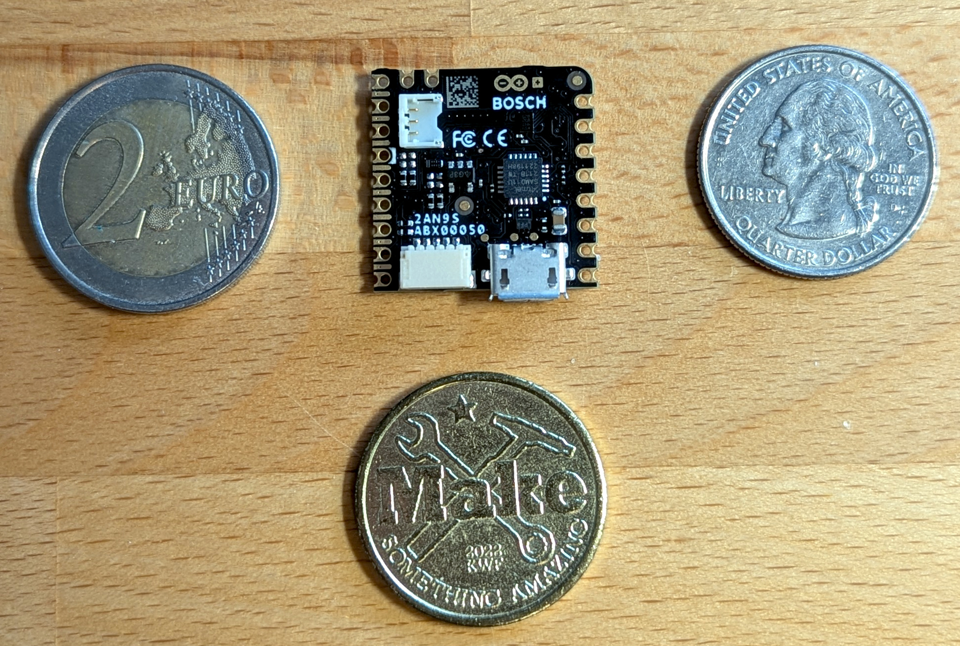

Nicla Sense ME next to three coins, each roughly the same size as the board.The Nicla Sense ME is a postage-stamp sized board based on the Nordic nRF52832. The nRF52 is a well known family for Bluetooth applications that already has robust Zephyr support. The Nicla board is also supported in the Zephyr tree which made for a very smooth experience when building firmware for the device. The slightly smaller size of Flash/RAM on the nRF52832 was no problem at all given the low overhead that Golioth’s Bluetooth SDK adds to the mix.
