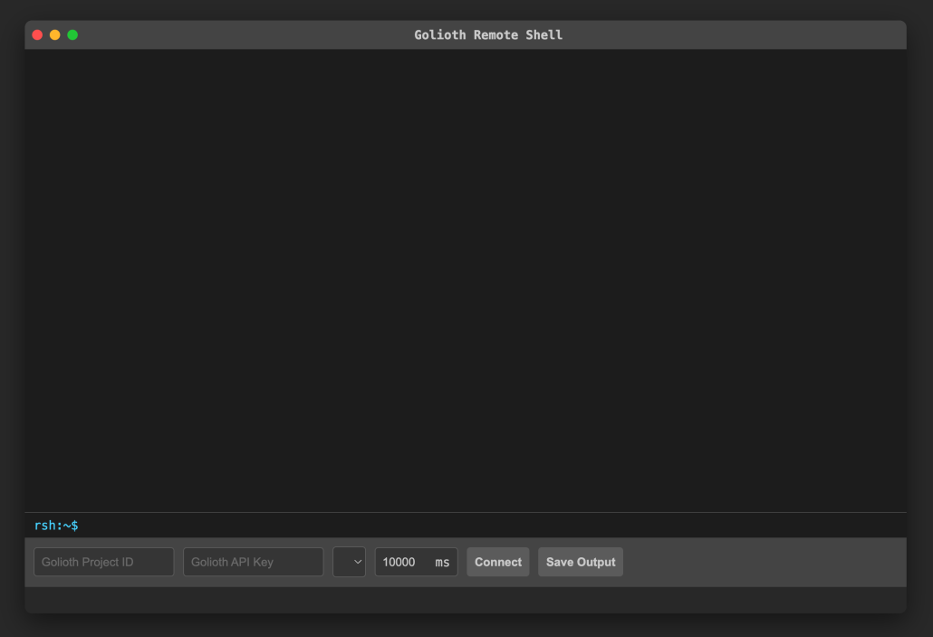

The Golioth Remote Shell demo app is deployed to Netlify. You need three things to make it go:
  • An API key for your Golioth account
  • A project name you want to access within your account
  • A device running the Remote Shell sample, which is built on RPCs and has a custom Shell backend

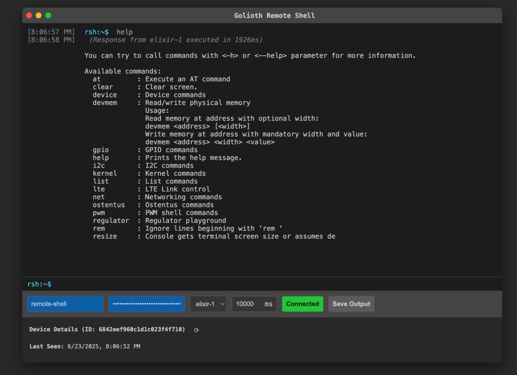

Once you are connected, you’ll see a dialog at the bottom showing the last connection time from the device to the cloud (using Golioth device metadata) and then you can type in a command like help and see the output from the shell returned to your browser-based interface:
Now you can interact with whichever shell commands are available on your device. I find the i2c, sensor, settings, and net shells to be particularly interesting. But check out this post about a range of Zephyr shells we like for IoT development.

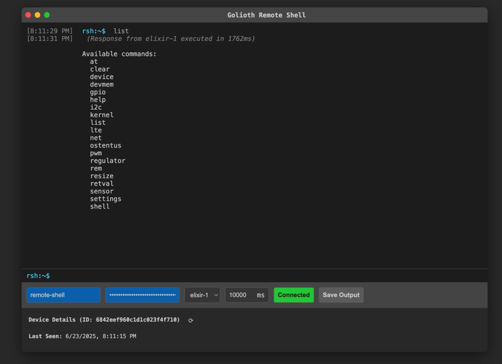

RPCs also have some limitations. One is that they have a sensible timeout: 10 seconds, though it’s configurable both on the REST API and as a result, in the frontend we created. The more complex one to solve is that we don’t expect responses to be larger than a CoAP packet size, 1024 characters. Some shell commands have very verbose output, for instance help like shown above. Note that I said I enjoy the sensor shell…but it’s not actually being listed! That inspired me to create a simpler (less verbose) listing of all available commands called list:
