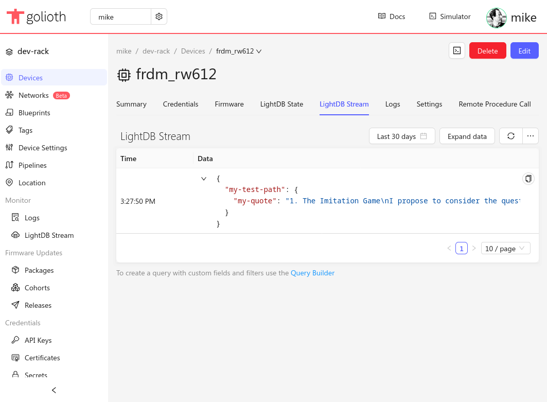

Once your device connects to Golioth, you can view the received stream data in the LightDB Stream tab of the device page.
Web console showing a JSON data structure that contains "my-test-path" and "my-quote" followed by a long quote from Alan Turing's writingsGoing Deeper with Blockwise Stream
