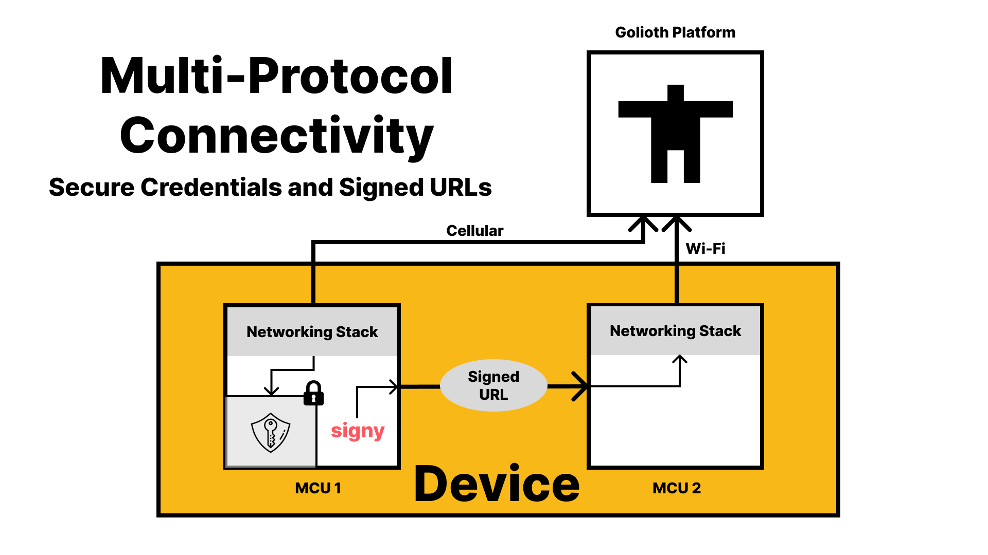

One motivating use case for this functionality is embedded devices with multiple communication interfaces. For example, many devices that connect to the Golioth platform leverage both cellular and Wi-Fi, with a separate microcontroller (MCU) managing each. Most modern MCUs support the ability to leverage a secure processing environment (SPE) for private key storage and cryptographic operations. The network stack running on the MCU is typically able to interact with the SPE in order to securely connect to an external server using (D)TLS or some other secure transport. However, the device manufacturer is responsible for generating private keys in the SPE and issuing certificates from their PKI during initial provisioning. If there are multiple components that need credentials to communicate over the network, the provisioning process and ongoing credential management becomes more complex. Furthermore, it may be the case that one component lacks sophisticated security features that are present on the other.
Diagram of Multi-Protocol Device with Credentials on Each MCU
With device signed URLs, a single component on a device can be provisioned with credentials, and can use its private key to issue time-limited signed URLs that may be distributed to other components over local communication interfaces (e.g. UART, SPI, etc.). Doing so grants the less secure component narrowly scoped access to a resource without transmitting any long-lived credentials.
Diagram of Multi-Protocol Device with Multiple MCUs but a single set of credentials.
