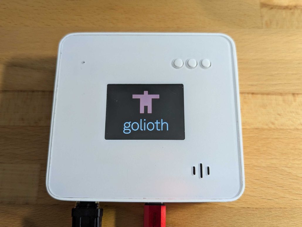

The gateway showed up from the manufacturer effectively without firmware; or at least without firmware that we could use in our scenario. Instead, Mike had to bring up the board using our bluetooth-gateway repository, which is built on top of Zephyr. We do have the FRDM-RW612 supported in that repository, but there were a few key differences.
  • The module had a different flash part than the FRDM-RW612, but it did match the in-tree board called rd_rw612_bga/rw612/ethernet
  • The bootloader required adding a button and LED assignment
  • The LCD needed to be defined in the overlay file
  • LVGL needed to be added as a library in the manifest
And most importantly, we needed to add a splash screen with the Golioth Logo:
Since the device is not meant to be opened by the end user, Mike enabled MCUboot so that new firmware can be loaded over the USB port using smpmgr. The factory would need to program the initial bootloader but then future firmware updates could be done over USB or more likely via Golioth’s OTA firmware update service.
