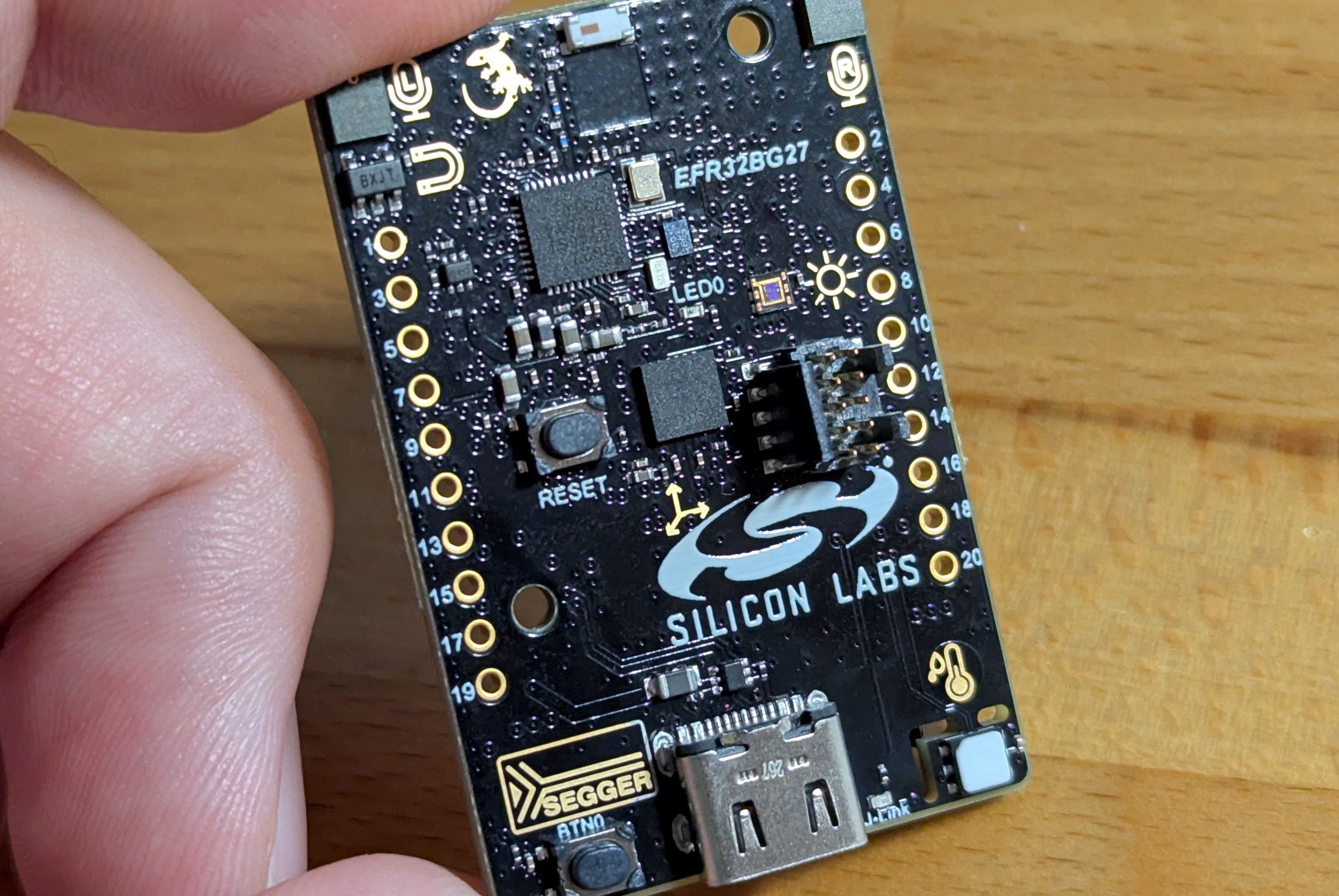

Black rectangular development board about the size of two postage stamps with a white Silicon Labs logo on it.This board includes an embedded J-Link adapter so you can flash it using the USB-C port and Zephyr’s west flash command. To access the Bluetooth features of the chip, use west to grab the binary blob.

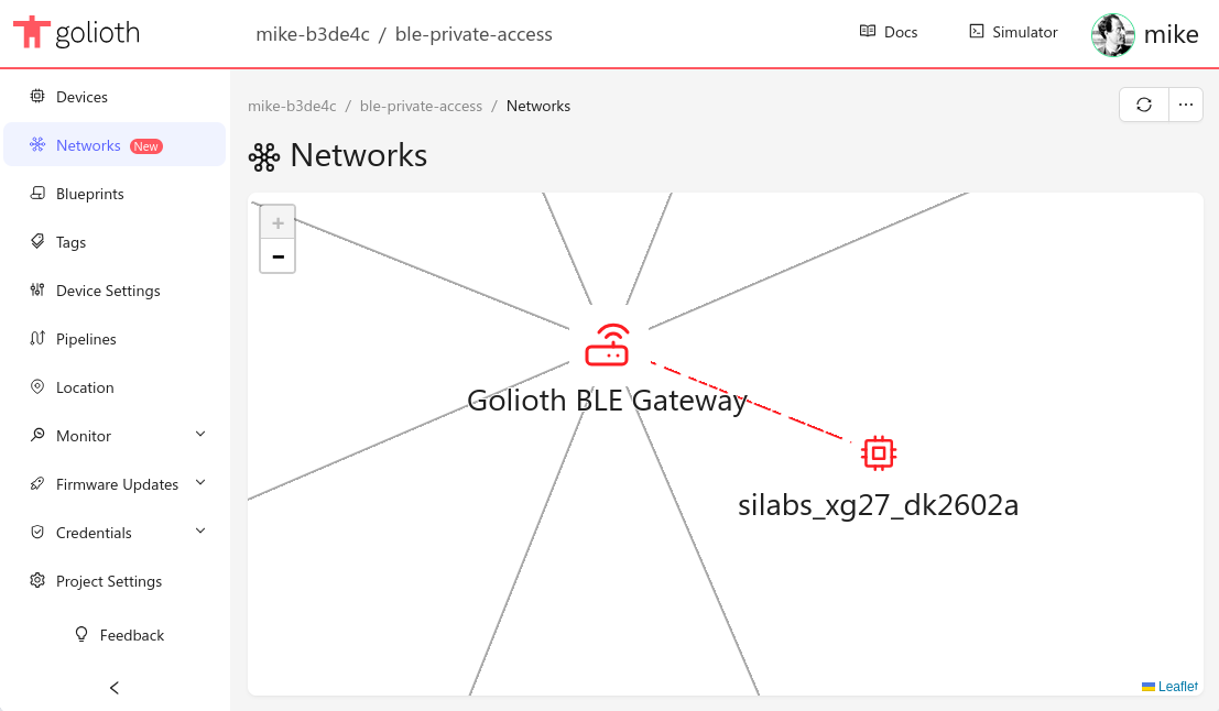

You should have already set up your gateway by following steps 1 and 2 from the getting started guide. If so, your newly flashed SiLabs board will soon be reporting into the cloud!
Golioth web console showing the SiLabs xg27_dk2602a connecting to the Gateway.Go Deeper with the SiLabs xG27

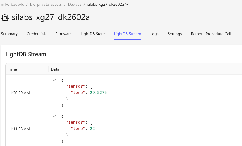

By default the Golioth example sends simulated temperature sensor data. But the xG27 dev board has a Si7210 sensor that includes a temperature reading. It’s far more fun to send actual sensor readings to the cloud so let’s update the sample to read that sensor!

And we immediately notice actual sensor data streaming in instead of the hardcoded value of 22:
Golioth console showing a simulated temperature of 22 followed by an actual reading of 29.5275Bluetooth to Cloud has never been this easy
