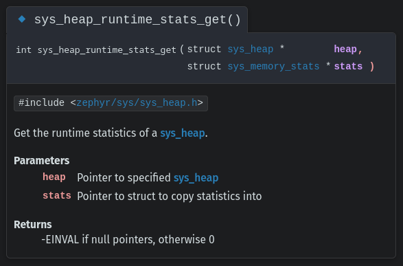

If you look deep inside the API reference for Zephyr’s low level heap allocator you’ll be delighted to find sys_heap_runtime_stats_get().
Zephyr API reference showing information about the sys_heap_runtime_stats_get() fuction.However, it’s not entirely clear how to get the pointer to the system heap that this function requires as a parameter. Luckily, we already know the kernel shell is getting these stats from somewhere so it is just a matter of grepping to find how it’s done. Let’s put together a test app to illustrate.

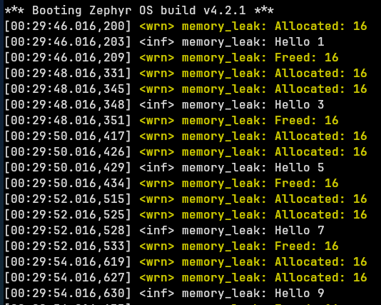

Zephyr Heap Listener
Memory stats give you running totals of what is happening with the heap. But it’s also useful to know where and when the allocations are happening. For this we can use Zephyr’s Heap Listener features. Let’s update our application to use listeners instead of stats.

This approach uses a familiar Zephyr pattern to define callbacks for the allocation and free events. These listeners are registered at run time so that the callbacks run each time k_malloc() and k_free() are called.
Zephyr shell output showing twice as many allocation events as free eventsWhen we look at this output it is pretty obvious that we’re allocating twice as often as we are freeing memory. For our simple application this visual pattern tells the whole story. But in your own test code, these callbacks can be used to keep track of the stats, or monitor for an imbalance between the two functions. There is also a callback available for heap resize events.
