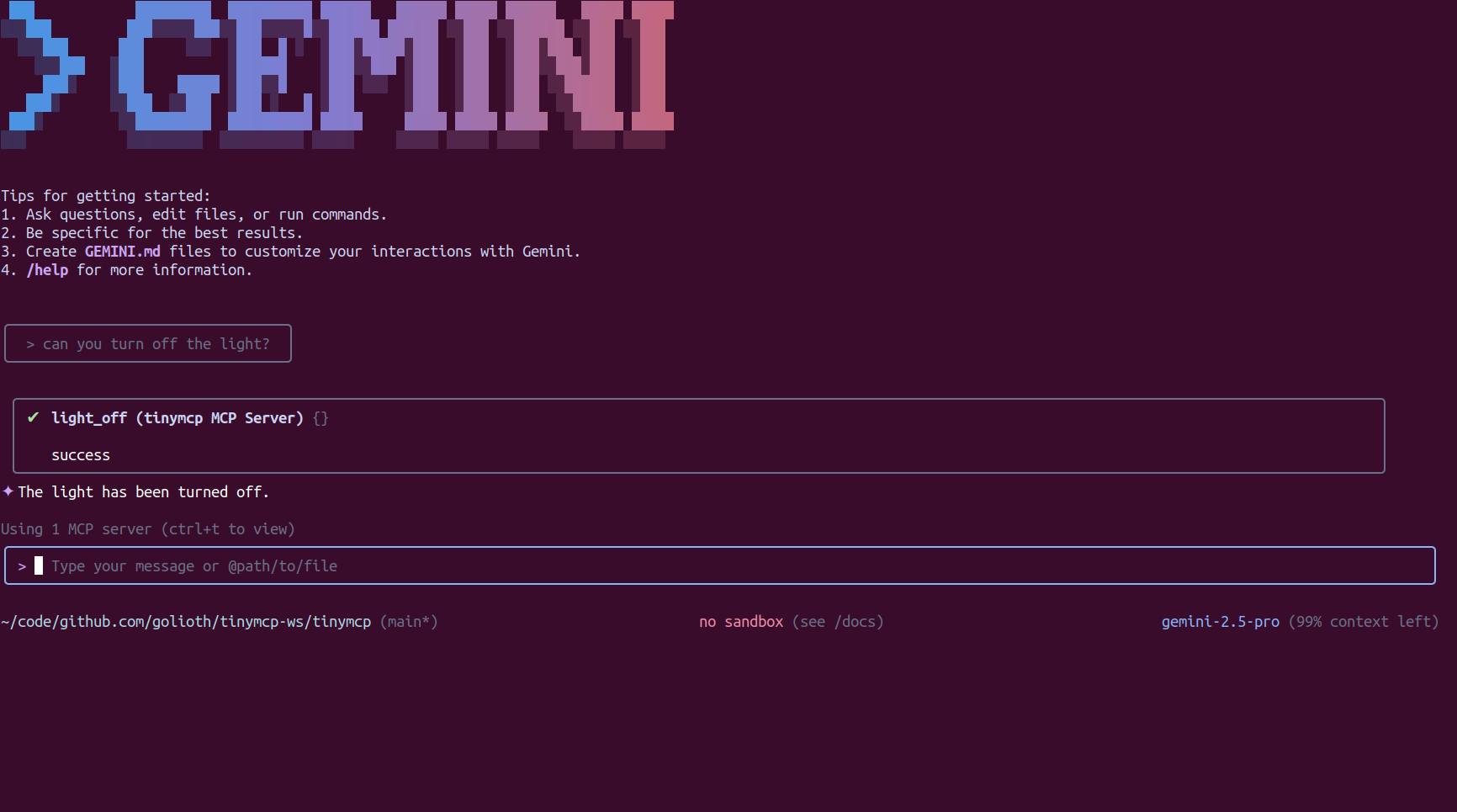

Asking Gemini to turn of the LED via the tinymcp server.

The tinymcp server can be registered with any MCP client, such as Claude Code, Cursor, or the Gemini CLI. Natural language can then be used to interact with devices, such as prompting the LLM to “turn the light off”.
