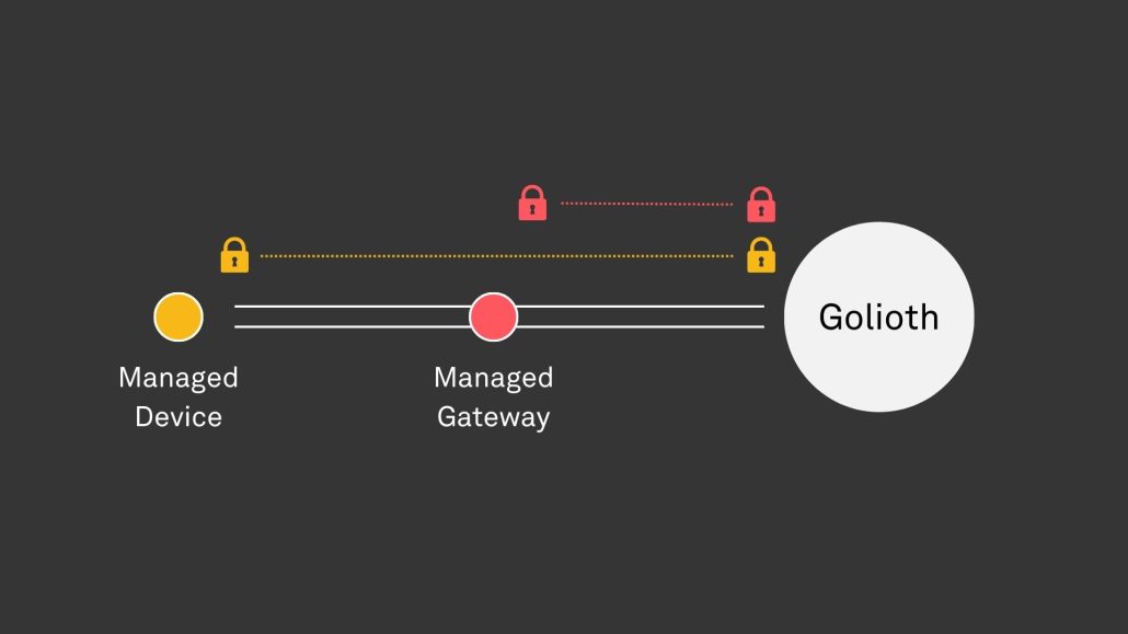

First, you need to look at our Pouch repository, which has a ble_gatt example. This is the basis for sending up a packet that has been encrypted with the cloud but is still allowed to traverse the gateway.
NT Managed Gateway Managed Device

One of the biggest differences everyday Golioth users might notice is that Bluetooth nodes must use certificates in order to connect to the cloud (through a gateway). This is explained in our introduction video for Golioth Connectivity and we’ll continue to publish about the role of security in our new paradigm of indirectly connected devices.
The example application we just built has a “Little Filesystem” (littlefs or lfs) included with it. That allows us to push certificates onto the device using some standard SMP tooling. You will first need to generate your own certificates using openssl; follow the Public Key Infrastructure (PKI) docs page to do so.
