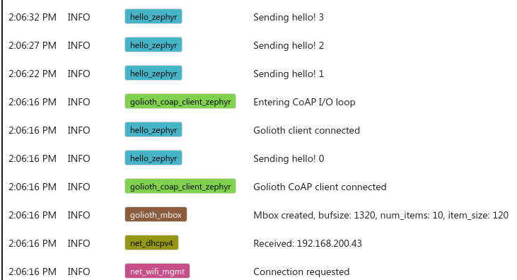

And when we look at the device logs on the Golioth cloud we see our hello world messages coming through from the Pico2 W!
Golioth web console showing log messages from a device: "Sending Hello! 0", etc.

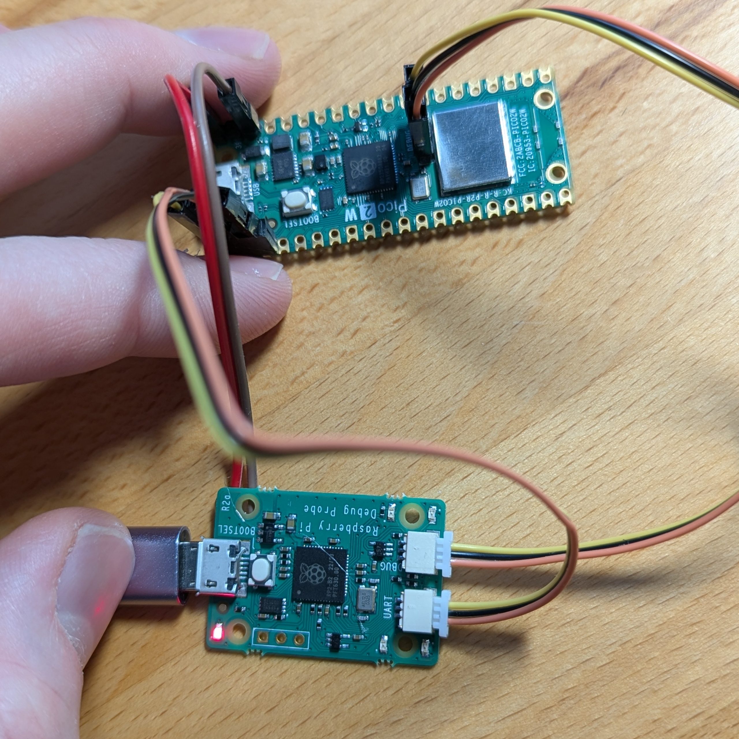

There are a number of gotchas to following along with the post so far. Zephyr supports a number of runners for flashing this board, including the UF2 bootloader. However, I’m using a programmer because I don’t want to push a button (and replug USB) to flash the chip.

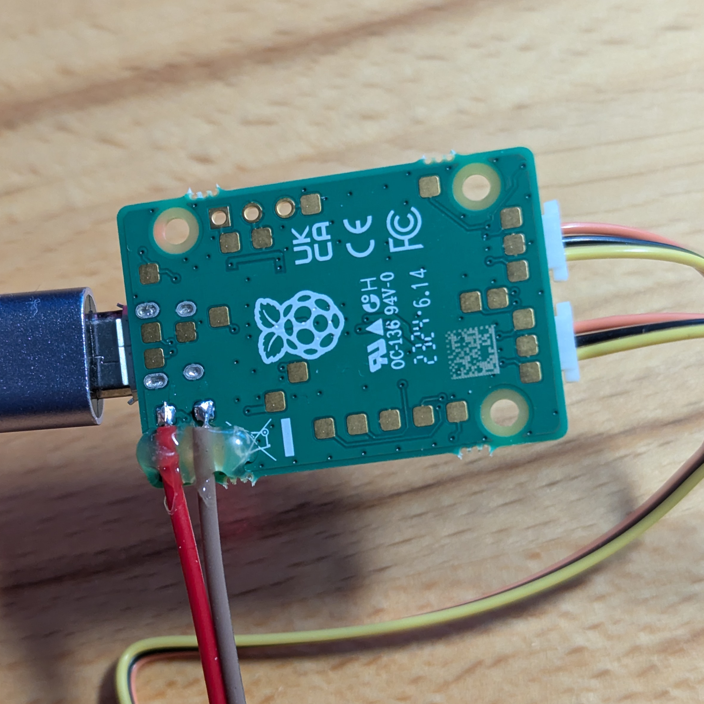

That’s okay, because Zephyr doesn’t have USB-CDC support for this board either. This means you can’t get logs from the USB port. I’m using the Raspberry Pi Debug Probe because it takes care of a number of these issues: directly program the chip, use the built-in UART to connect to the chip’s console, and I’m using a hack to power the Pico from the debug probe (do so at your own peril).
Edit: Thanks to Chris Wilson who pointed out that USB-CDC worked on the Pico and should also work on the Pico2 w. I went back and tried again and was able to get it working on the usb-cdc sample with a bit of devicetree work.
Using this arrangement, I only need to plug USB into the debug probe and I can flash, debug, and monitor serial output.
