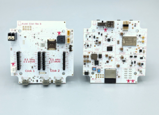

Chris Gammell has designed a great line of custom boards for Golioth to use when standing up an IoT fleet. We call these boards the Aludel, and have both the Elixir and Mini models. With the Aludel Elixir model there are two variants that have different hardware and slightly different chips.
The challenge comes when you learn that all of these device types are running the same Nordic nRF9160 cellular modem as the main processor. So it is entirely possible to send the wrong firmware to one of these boards. It will flash, and will probably run, however the expected pin assignments are going to be different from one device type to the next. None of the peripheral devices are going to work!

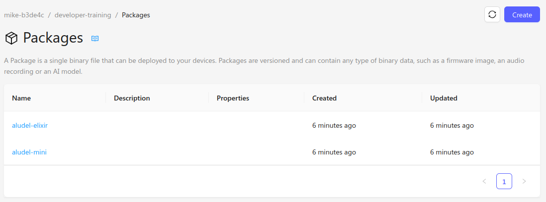

Golioth Console viewing packages. aludel-elixir and aludel-mini are shown.In the Golioth web console, navigate to your project and create one package for each of the unique package names you have used in your firmware build. Above you can see I have created two: aludel-elixir and aludel-mini.

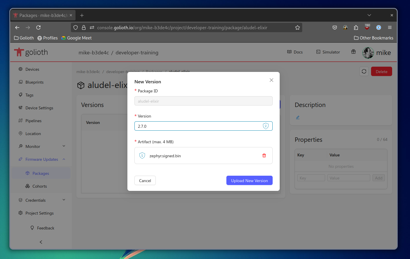

Adding a new package version on the Golioth web consoleNow that my packages have been created, I can click on the package name and use the New Version button to upload a version. Input the version number, choose the binary to upload, and hit the Upload New Version button.

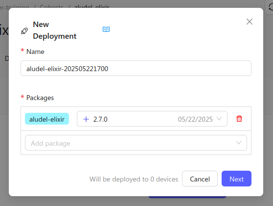

Golioth web console showing a new deployment being readied.Finally, navigate to the Cohorts entry on the left sidebar, choose your desired Cohort, and click on the Deploy button. You’ll be greeted with the dialog shown above. Choose your desired packages and versions; you will be limited to the packages that have already been uploaded to the Golioth platform.
Click Next to review your changes, and if everything looks okay click Start Deployment to roll these out to the fleet. More precisely, roll it out to this Cohort of your fleet!
