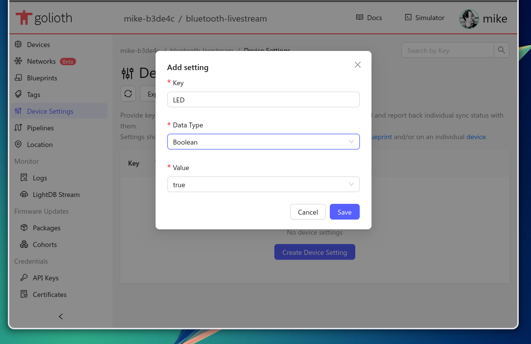

The sample Pouch application already supports the Settings service to switch an LED on or off remotely. From the cloud, this is just a few clicks to add a boolean setting called LED.
Adding a boolean setting to the Golioth Settings service using the web-based console The device-side code that supports this setting couldn’t be easier. It’s made up of a function that will run as a callback, and a macro to register that callback.

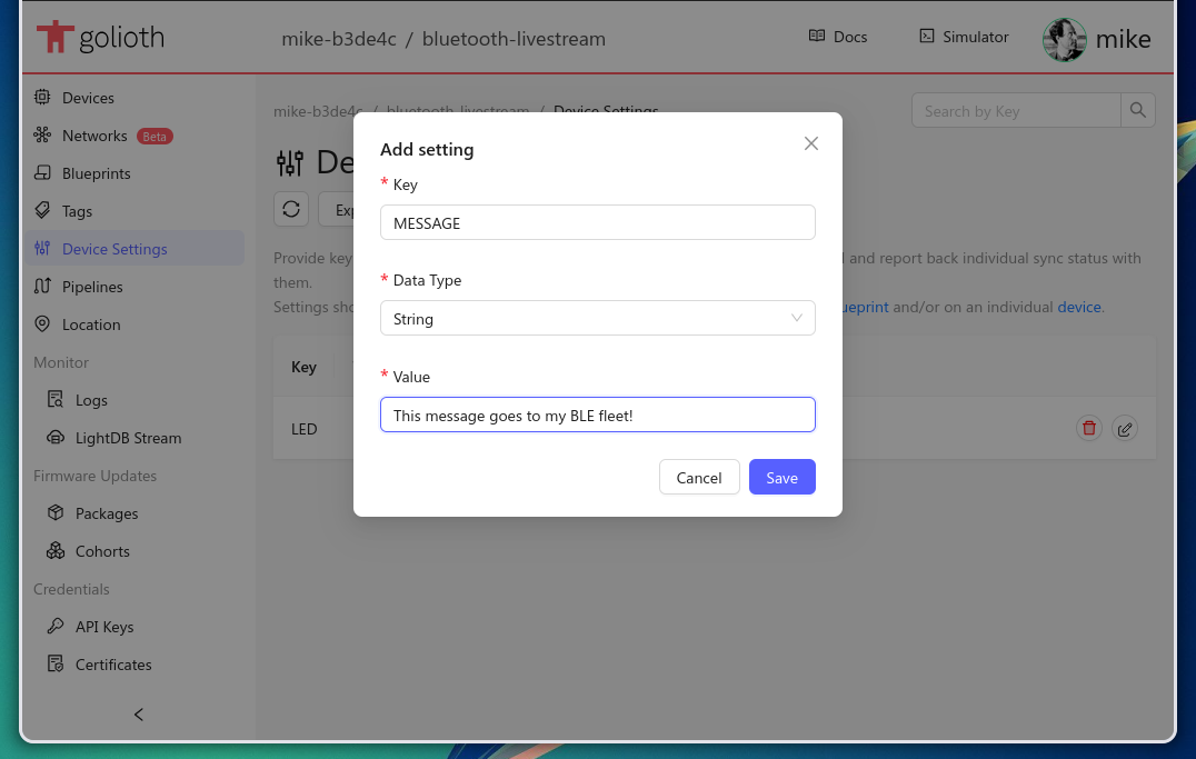

If your Bluetooth IoT devices have a user interface, like a screen, you may want to send messages to them. Lets add a setting that sends a string to the fleet. First, add the setting in the Golioth web console.
Golioth web console used to add a string setting to an IoT fleet.The screenshot above shows a setting called MESSAGE added as a String type. The value is the string that should initially be sent to the fleet. The value may be changed at any time (although the key and data type are immutable because they need to match what is built into the firmware).

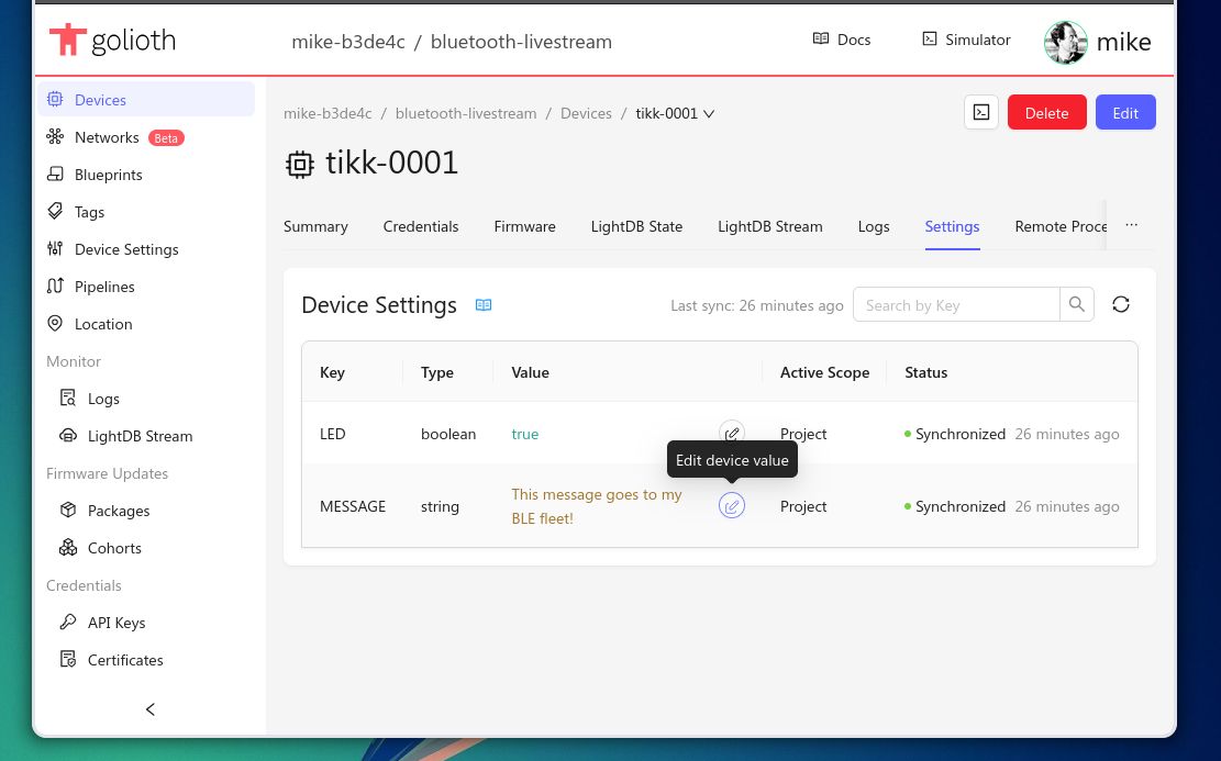

Despite a few differences, this continues to be extremely easy to implement. Once the device is in the field, you can drill down to control a single member of the fleet from the settings tab of its device page.
Golioth web console showing the setting override for a single device
Change the setting for a single device from the Settings tab of the device page.
